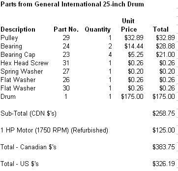

How about those who built their own, i built mine for $250.00 CAD and i'm happy with it, i'm also curious of what Rod, BobC, Mario and others who built their own would recommend on that matter!
Kim, you also have acces to a great woodworking website in your country, woodwork forum with great homemade drum sanders, that's where i learned more about it!
